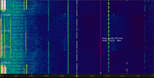

M23 on 14100 kHz
« Reply #2 on: March 20, 2019, 1110 UTC »
Yesterday M23 showed up at 16:58 UTC on 14100 kHz with ID 051. This is an exclusive ham radio allocation, used by IARU/NCDXF propagation beacons.
See waterfall capture:
M23, on ipernity
Offline SV1XV
  • Posts: 286
  • Athens, Greece
    • SV1XV blog
Re: M23 logs + Help finding the transmitter location!
« Reply #3 on: March 24, 2019, 1806 UTC »
Since March 19, 2019, M23 has mainained this "051" schedule on 14100 kHz on a daily basis, from 1658 to 1710 UTC.
