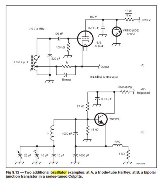

I have only used crystal oscillators for my builds, but crystals can be hard to find that match the frequency you want to transmitt on. Is there any good and simple VFO altnernatives for HF using a colpitts oscillator for example?
I am looking for something like the lower example in this image, from the ARRL handbook. Is this something i should go for, or is there better and prooven designs?

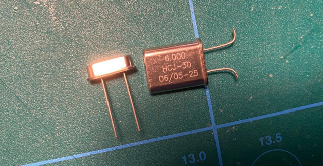

I tested a few crystals i got on line, but they didnt work. Some of them(the one on the right) worked very well, but the one on the left didnt work at all, both the same frequency though. Is there any difference between them that is important(besides the size)?

I don't know how you are testing them but crystals can be designed to operate properly in either a series or parallel resonance mode
Jim
