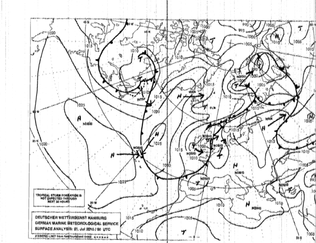

In Europe the most commonly received weather FAX service is the German Meteorological Service (Deutscher Wetterdienst or DWD), which transmits from Offenbach throught the day. The DWD frequencies and callsigns are:
Callsign Frequency
DDH3 3855.0 kHz
DDK3 7880.0 kHz
DDK6 13882.5 kHz
