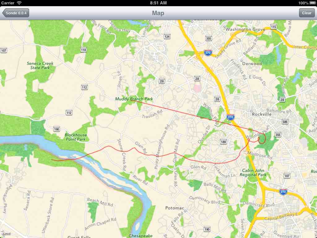

Here is a map of the path based on the captured GPS data:
The straight line from Muddy Branch to Rockville is due to lack of data during that time period. That was the beginning of the capture period.

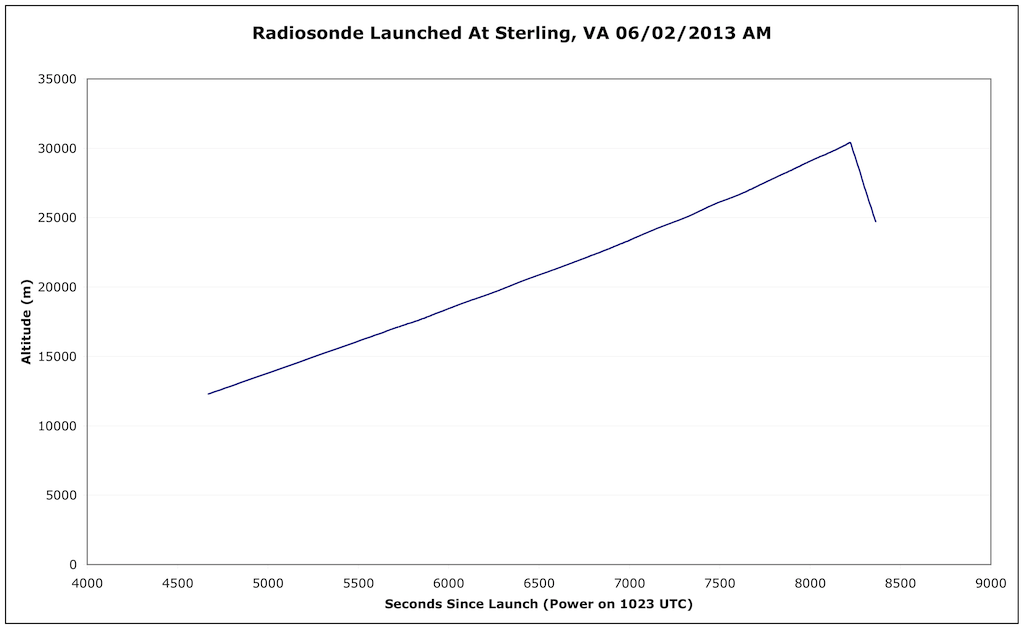

Here is a plot of the altitude:
After the burst, the sound of the signal immediately changed and the signal level dropped a lot, I guess due to the sonde tumbling before the chute opened. By the time it did, the signal was already too weak to decode, although I could hear it until 1300 UTC.
When it stopped decoding (just after crossing back into Virginia) it was almost exactly 50 miles away.
