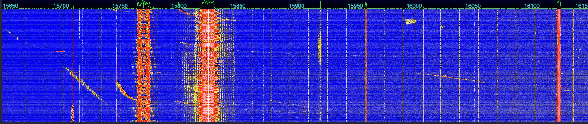

Saw some unusual things today:
I have never seen the degree of "flaring out" near decay as seen today in the 2 on the right.  In between is one which seems to slow down its descent in frequency, and then descend some more.  A couple I saw today had a very pronounced reverse S curve.

« Reply #32 on: November 14, 2014, 0056 UTC »
J, the flare at the end is a common feature seen here.  Also the shape can go back and forth, have seen them reverse, even make hard corners.
