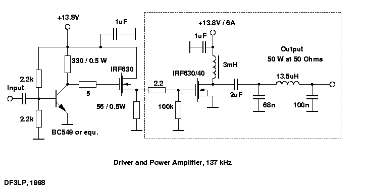

Hello,
I'm looking for schematic of AM signal generator(with voice input).
I don't like x-tal - i want schematic on LC(capicator and coil in shield).
http://www.qsl.net/df3lp/projects/lftx/tx50.gif
73! irf510
