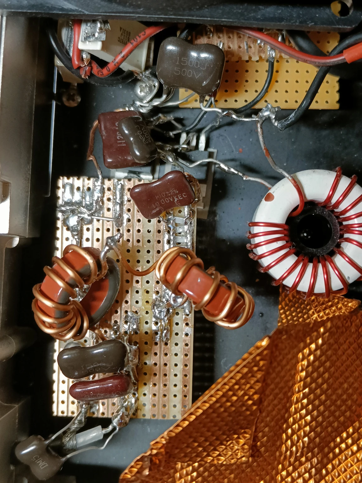

Tonsku79
  • Newbie
  • Posts: 7
Re: U-LULU (Updated LULU) for 48 meters, 20 Watt Class-E AM Transmitter
« Reply #50 on: October 06, 2026, 1758 UTC »
Some more progress. Now using two IRF530's in parallel just in case. New tank/output circuitry.
This thing generates now reliable 200Watts PEP (50-60W carrier). Supply is 36Volts, I think this is now close to or exceeding the max voltage rating of those IRF's.. however still no mosfet failures no matter how long and how hard I push this little TX.
Both fets has their own gate driver chip.
Yes, I know, this looks horrible  ;D
