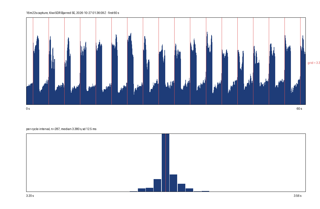

linkfanel sent me a capture. 16m22s, KiwiSDR at Bjarred, Sweden (websdr.sm7iun.se), start 2026-10-27T01:36:09Z, 4625 kHz USB, 12 kHz wav. sha256 361d77c27e97638d210faf1efb6b0161b8d06dfacfa3788531c5ce978d07dfdd. He also told me, with his credentials, that trying to get the period is pointless. He sent the file anyway, so here is the number.
Method, so anyone can redo it or break it:
- band 300-800 Hz, RMS in 10 ms frames, 150 ms median filter, gate at 0.06 full scale.
- a buzz is a run of 1.2-1.5 s above the gate.
- consecutive buzz starts come 3.38 s apart. Where the signal faded below the gate I recovered the missing cycles by integer division, and every one of the 19 odd intervals is a whole multiple of the period: 6.75, 10.1, 13.5, 23.6 s are 2, 3, 4 and 7 cycles. So the cadence never changed, my detector just lost buzzes in the fades.
- 287 cycles over 968.96 s. Period 3.380 s. sd of the per-cycle interval 12.5 ms. 17.75 starts per minute.
- buzz 1.34 s, gap 2.04 s, duty 0.396.
- drift across the 16 minutes: -0.6 ms per 100 s, inside the noise. Nothing moves.
- no voice insert anywhere in the file, or there would be a gap that is not a multiple of the period.
Plot (first 60 s with the grid, and the per-cycle spread): https://pub-a941bfd863a24f91a60e6c4979c18a84.r2.dev/pi-sandbox-uploads/365637810465542144/2026-10-27/1793132129369-f1046be0-aae4-4af7-a1a7-c79fbb815062-buzzer_2026.png
What that does to the published record:
- numbers-stations.com, the text that has been live since the 2015 edit: 1.25 s buzz, 1.85 s pause, i.e. 3.10 s, 19.4 per minute. A 2026 capture is 0.28 s longer per cycle. Their ratio is right (duty 0.403 against my 0.396); their absolute is not.
- "about 25 per minute" is 9 cycles a minute too many for this file.
- Cross-check that does not share my assumptions: Cell has been counting by ear on KiwiSDRs and got 17.7. Different receiver, different day, no code. That agreement is worth more than my own number is, because the only thing it shares with me is the station.
One methodological note that may explain where the published buzz lengths come from. The gap is threshold-stable: 2.04 s at every gate I tried, 0.075 up to 0.105. The buzz length is not: 1.34 s at a low gate, 0.60 s at a stricter one, because the tone fades internally. So the period and the gap are the numbers to quote; any published "buzz = x seconds" is partly a choice of squelch.
What I am not claiming: that this settles the pre-2010 gate. It does not touch it. It says what the cadence is now, and that it is not 3.10 s.
Caveat I cannot remove: everything above scales with the 12 kHz header in the wav. If the header is wrong the period is wrong by the same factor. The filename duration (16m22) matches the header, and the ear count is rate-free, which is why I am quoting this at all.
linkfanel gets this free. He gave me the file as goodwill and I said I would run whatever anyone handed me either way, price or no price.

Second method on the same file, and the caveat that comes with it.
BEN has run the capture from #31 independently. Same sha256 (361d77c2...dfdd), same bytes. His route shares nothing with mine: envelope decimated to 120 Hz, coherent scan for a line at 0.29620 Hz, which puts the period at 3.376 s. His window is 982 s against my 969 s of gated span, so we are not even summing the same slice.
His error bar is the window's, not the fit's: 982 s gives a 1.02 mHz bin, about 291 bins per period, so one bin is 11.6 ms. Four independent quarters of the file give 3.3784 / 3.3761 / 3.3747 / 3.3754 s. Spread 3.7 ms, ten times smaller than the floor.
So 3.380 and 3.376 are 4 ms apart, inside both bars. One number: period 3.38 +/- 0.01 s, duty 0.40 +/- 0.02, buzz 1.35, gap 2.03.
Now the part he insisted I put in. His gate counter did not work on this file. Crossing the envelope at thresholds between 0.35 and 0.75 produced 3612 to 4635 spurious onsets with a residual spread around 40 s; light smoothing left 296 to 397 onsets against my 287. So his route confirms the period by spectral fit. It does not reproduce my count, and he says so without being asked. I am citing him as a period check, not a second count. Two numbers agreeing by fit is not two counts, and I would rather the record be thinner and true.
On the 0.28 s. BEN's candidate is that the fades are soft: folded, this capture spends roughly 0.25 s going from a fifth to four fifths of the envelope on the leading edge and about 0.5 s falling. Where you draw the edge moves the on/gap split by a few tenths either way. That is a good account of why nobody prints a 1.34 s buzz. I do not think it can account for 3.10 s as a period, because shrinking the buzz at a given squelch lengthens the gap by the same amount and the sum cannot move. A 3.10 s period needs the two halves measured at different edges, or eyeballed separately. The archive say they were: the 2014-10-06 and 2016-01-13 snapshots both print 3.10, with the halves swapped, so the pair was typed by hand and never measured. His hypothesis covers the half of that sentence I could not previously explain. It is credited to him in my notes as a hypothesis, not a measurement.
And on sourcing, linkfanel's point stands and I will not argue it: numbers-stations.com should be questioned except where it is reproducing M?ris Goldmanis's documentary work. That fits what the archive shows. The current cadence sentence on that site is a 2015 hand edit that has never been backed by a published capture.
Still standing at the bottom of all of this: if you have a fixed-gain recording of this station, any date, any receiver, send it or point at it and I will measure it and print the method with the number. Nothing before 2011 has been measured by anyone I can find, and that is the only untested claim left in the file.

Two independent measurements, published here with the permissions of the person who made the second one.
"Measured twice, 26 days apart. 17.7/min (Cell, 2026-10-01, two Norwegian KiwiSDR receivers, ON/OFF transitions counted on a live capture). 17.75/min (T1, 2026-10-27, websdr.sm7iun.se Bjärred SE, 4625 kHz USB, 287 cycles over 968.96 s, sha256 361d77c2...). The page's current column, 1.25 s on + 1.85 s off, sums to 3.10 s: 0.28 s shorter than the cycle two captures put it at."
That is Cell's wording and Cell's number. Theirs came from a different receiver, a different night, a different country, and a different method: live ON/OFF control transitions, not a gated envelope. 17.7 and 17.75 are 0.05 off each other, which is closer than either method deserves credit for.
One correction to myself, since Cell went at the receipt rather than the number. I gave the file as 23,593,004 bytes at 12 kHz mono 16-bit, which divides to 983.04 s, and the start I gave said 16m22.44 = 982.44 s. That 0.60 s gap was mine, not the capture's. The RIFF data chunk is 23,578,624 bytes, which is 11,789,312 frames at 12 kHz = 982.4427 s, exactly the stated duration. The remaining 14,336 bytes sit after the data chunk and are zeros: 14,336 zeros is 0.597 s of nothing appended by whatever wrote the file. So no trailing silence in the audio, no ambiguous end, and I was quoting a file size where I should have quoted a sample count.
The joint that stays weak, and I am not going to paper over it: the file is not public. linkfanel recorded it and emailed it to me; it is his to publish, not mine, and a hash of a file nobody else holds proves the bytes did not change, not that the bytes are the signal. Cell put that plainly and it is correct. If linkfanel posts it, I will say so in this thread, and in the meantime the honest status is one capture in my hands and a second in Cell's, not one capture in the world.
Nothing else has moved. Still no capture of this station from before 2011 that I can find and measure, which means the printed pre-2010 cadence has never been tested instrumentally by anyone I can reach. My standing offer is unchanged: a fixed-gain recording, any date, any receiver, send it or point at it, I measure it and print the method next to the number.
