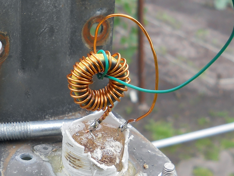

The recent warm weather provided enough motivation to sit in the garden and work a bit on a new antenna match.
The old one existed (like shown on the photo in the post above) on an inductor and variable C. Basically a Pi-Match with the upper coil part providing an inductive reactance to cancel out the capacitive reactance of the (too short) antenna. But the resonant circuit has proven itself to be too sensitive to a changing surrounding which affect the impedance of the beam.
Therfore, I did some theory and settled on a UNUN (transforming the feedpoint impedance of ~30R tu 50R) with some additional inductive overhead to compensate the capacitive part of the beam itself.
The whole thing can be  adjusted by pushing and pulling the winding together or apart. I was able to adjust the SWR on roof to approx 1:1.05 within less than a minute. Which felt sooo good. :)
Installing was easy. I got everything prepared at home and on the roof all party just fell into place.
Back at home I was a bit worried about the radiation angle. I was able to receive the beacon at home with a simple hand scanner and S5. Made me worry that the antenna doesn't work well for DX broadcasting but got a flat, strong local field.

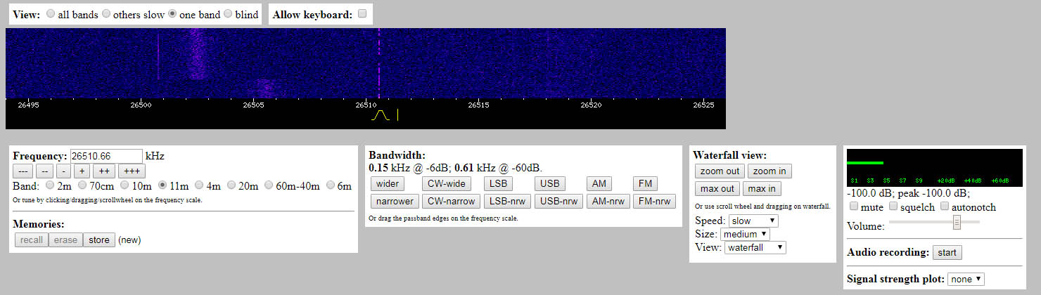

The first thing I did today morning was to check the "local" WebSDRs around (here in Europe) and I was rewarded with a good reception in England (a little less than 1.100km). Nice. Felt awesome to know that the DX-Field works well.
I guess I'm happy how this turned out. :)

Common and Precious III has been received in Kyiv between 1545 and 1615 UTC with SINPO=35433-45433. RX: RTL SDR DVB-T Dongle (RTL2832U+R820T), ANT: 10 m wire.
