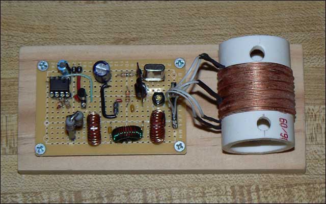

Cute! I'm guessing 20m with that coil? Nice work.
The two transistor rig posted elsewhere is a nice one based on the "universal QRP transmitter" published by Wes Hayward.  Thousands built I'd guess.

That looks a whole lot like the Michigan Mighty Mite circuit that I've been tinkering with recently...
Here with a chebyshev filter on the output, which I'm still not sure is actually doing anything for me.
That "Unversal QRP Transmitter" circuit has been giving me fits for some reason.  I think I may have an idea of what I'm doing wrong, but need a little bit of "quality time" with the soldering iron to try out an idea or two.  I managed to find a wiring error I had in one of my recent attempts, which converted the board from a board that transmits smoke to one that produces no output whatsoever, and have identified two possible problems that I need to experiment with.
Good, clear photos of the componentry in a working "Universal QRP Transmitter" rig would be very helpful for me to see, if anyone has them, as well as details of the L1/L2 RF transformer.  A unit built for the 40-meter-ish band would be nice to see, but at this point I'll take anything I can get.
