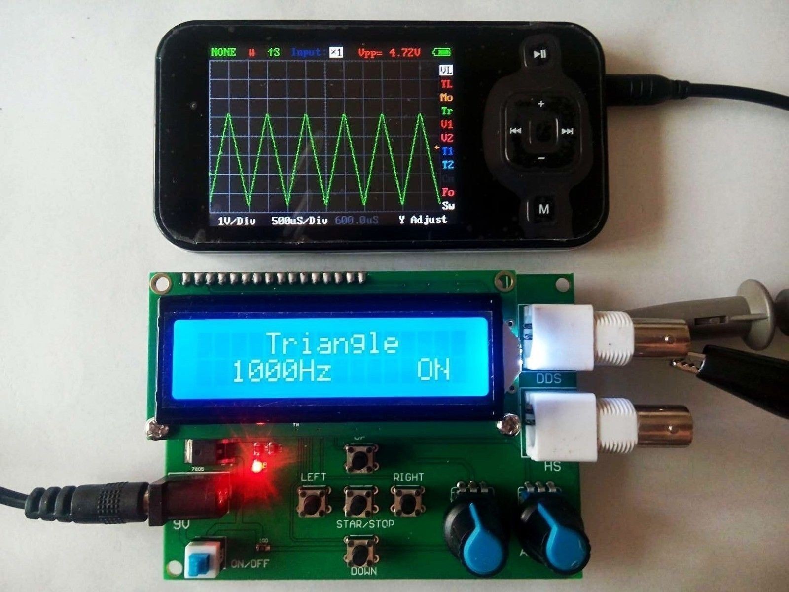

I've been watching the various flavors of Chinese direct digital synthesizers (DDS) on eBay and you can get a lot of capability for low prices.

Features:
Main AVR DDS V2.0 signal generator features:
Dedicated high speed (HS) signal output up to 8MHz;
DDS signal with variable amplitude and offset;
DDS signals: sine, square, saw, rev saw, triangle, ECG and noise.
2×16 LCD menu;
Intuitive 5 button keypad.
Frequency adjusting steps: 1, 10, 100, 1000, 10000Hz;
Restores last configuration after power up.
You could unplug the circuit board's display to save a bit of power when it is operating unattended..
The DDS is the green circuit board in the lower half of the picture.
YouTube video review  https://www.youtube.com/watch?v=2zojBi2fvwU
The reviewer points out some design flaws but for under $14 it is hard to complain.
Jim

That one is not an RF DDS. I got one of those before knowing that. The HS output is a square wave derived by dividing the clock so its only 16Mhz/n. 1,2,4,8Mhz.
The other output only goes up to 50Khz I think. I never built it and don't have the specs handy. What you want to look for is something based on an AD9850 or AD9851.

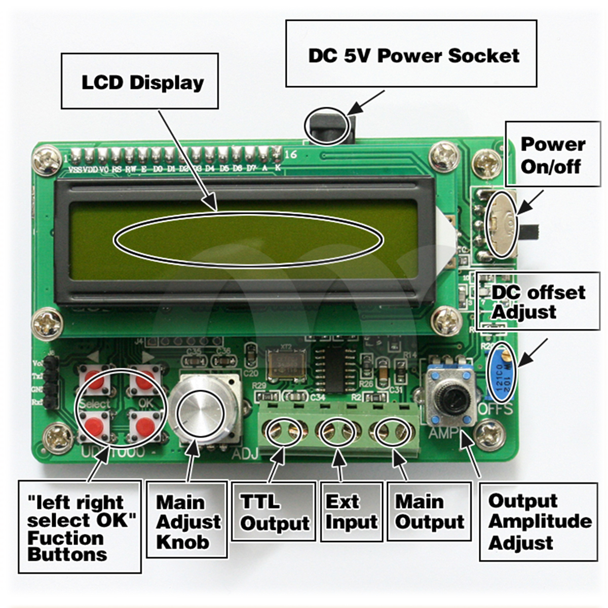

I actually have one of these assemblies (UDB-1005S) pictured below. It is the 5MHz version for $30 and I have it outputting 4 MHz at the moment
https://www.ebay.com/itm/UDB1005S-Function-Signal-Generator-Source-Frequency-Counter-DDS-Module-Wave-5MHz/321418276142?ssPageName=STRK%3AMEBIDX%3AIT&_trksid=p2057872.m2749.l2649
So if the one in the first post can only output in the 50 KHz range then this flavor of DDS is better for the hobbyist a little higher cost. They also sell 8 MHz and 10 MHz output versions for a bit more.
Jim
