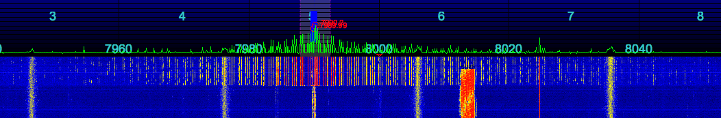

  • Posts: 32483
Re: Wideband, High-Pulse Radar
« Reply #1 on: September 26, 2013, 1859 UTC »
Here is what it looked like here:
