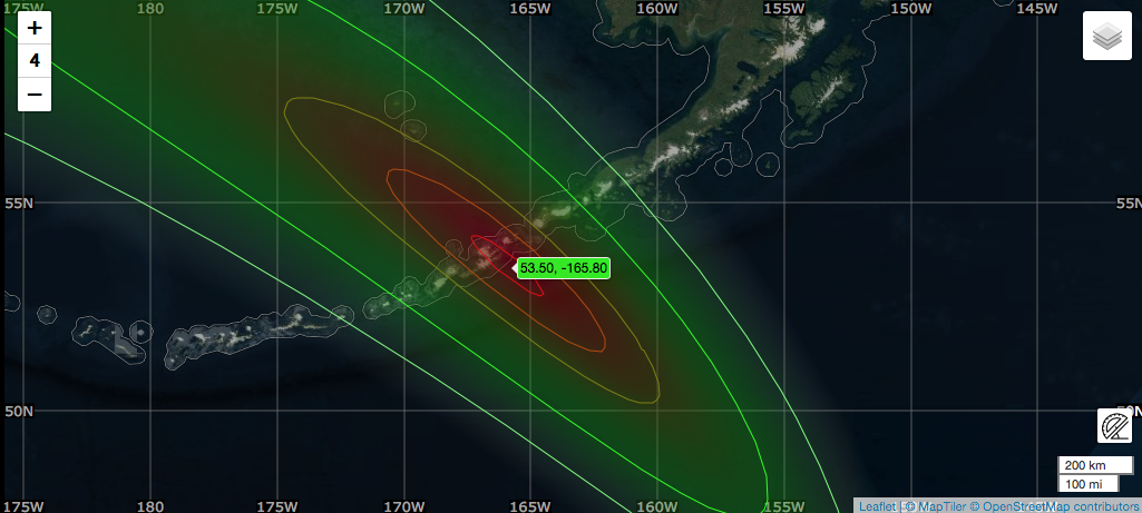

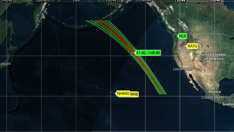

I tried to do a TDoA for the signal and it took a lot of checking to find any kiwiSDRs that could pick it up! I tried 15 different ones around the country with no success until I tried Point Reyes CA. Nice strong signal there. From there I found other SDRs on the west coast that could pick it up.
I ended up using NA7U in Idaho, NAK in Washington State and AI6VN/KH6 in Hawaii. KPH came back with bad data so I left that out.
The results?
I tried again hoping to get good data from all stations. This time KPH worked but I got bad data from the Hawaii station and it was excluded. MUCH more interesting results though putting a nice hotspot right on the Fox Islands in the Aleutians.
The Fox Islands are uninhabited but the two islands within the forth most ring at the top are St. Paul and St. George islands, the Pribilof Islands. Both are inhabited. I am not aware of any current broadcast sites there. St. Paul used to be a LORAN site back in the day. Maybe someone is testing something new?
