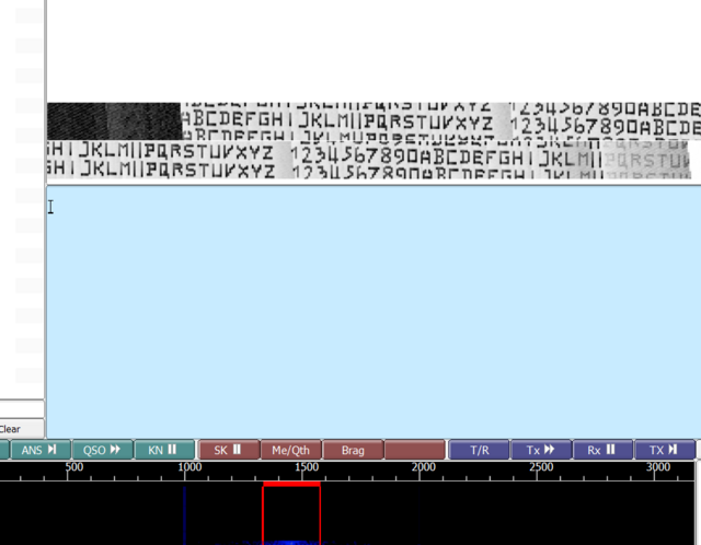

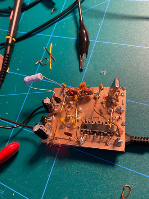

I thought i would share a small side-project, sending Hellschreiber from a small HF-beacon using a arduino. I took some effort to write the code in such a manner that it would fit in memory of a Nano, but it worked in the end! The code is simple tu use, just enter a string and it will send it.
Hell has a few good low-power alternatives, as slow hell. It should just be a question of setting the "speed" right(the number of micro seconds each dot take). But i have only gotten it to work with the normal field hell so fat.

I did some test with slow hell, at 1/8 of the speed of feld hell, it worked nicely. I had to re-make some of the code but it was done quickly, the longest microsecond delay is something like 16000us and you need about 32ms in on/off time in slow mode. There is now a comment describing what time to youse, in the code.
It would be interesting to see if there is any program that can recieve even slowe Hell than the oridnary 1/8-speed of Feld.

Excellent, thanks. Questions: Is the photo that you posted above just the transmitter part of the Ardushcreiber? I can't tell by looking, but I don't see the Arduino Nano there.
And thanks for the code.

« Reply #7 on: June 24, 2020, 1938 UTC »
The arduino Nano is glued to the under side of the circuitboard :) I used hotglue to attach it, and it worked really well. I will post a couple of pictures soon!
