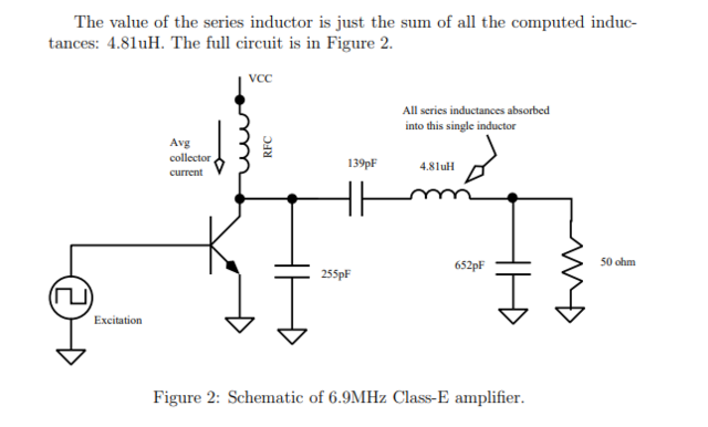

Also tried this circuit from https://www.researchgate.net/publication/320623200_Notes_on_designing_Class-E_RF_power_amplifiers But i got no usable power from it.
This Class-E stuff is clearly more complex than i expected.
My biggest problem with this paper and this circuit is that to specify a Class-E output network as he has without specifying a transistor is somewhat misleading; it fools the user into thinking that they can plug any old transistor (even a MOSFET) into it and expect it to work. Maybe this would work at 50 KHz with old power MOSFET transistors (which tend to have humongous output capacitance that swamps any other performance differences between models of transistors) but not at 6.9 MHz (as in the paper). The reality is more complicated and the component values of a Class-E network absolutely have to be tuned and optimized for each transistor at each frequency.
Also, it is humorous to me that this author does mention that he performed SPICE simulation but again without specifying what transistor was used and without providing any actual measured results to go with it. Had he substituted another transistor into his SPICE model, he would have seen exactly what I wrote above - the matching network has to be tuned and optimized for a particular model of transistor, which would make it obvious that specifying a network needs to be accompanied by naming the actual transistor used.
This paper is one of these garbage undergrad papers that people put out to pad their resume/CV; there's nothing new in there and it's lacking aspects that would make it useful to others. He references Sokol's book on Class E  but then goes through a bunch of derivations that Sokol already did in his QEX article from 6 years before the book. I don't see the point.
I'm sorry that you wasted your time expecting this kid's navel-gazing project to work. That's a few hours of your life that you won't get back.
This is the primary reason I'm sticking with CMCD.  The design process is as simple as tuning the tank to resonance and going about your day.  In theory you could precisely calculate the tank values taking into account the Cds and so forth, but I found it much easier to spitball it.
OK, I'll take your word for it.
For what it is worth, I haven't built any yet but I have done some simulations with a few different power transistors in CMCD configurations for 43 meters and the optimized results have ended up with very different tank circuits; the same network (parallel RLC between the drains) but with very different component values depending upon the transistor.
Now, to be clear, my design process in the simulator is to do a bunch of sweeps of the RLC values to pick values that basically work then I put the optimizer to work to peak up the output power and efficiency, minimize power dissipation, etc. From there I usually end up tweaking it for one reason or another. The reason I mention this is because the optimizer can spend minutes trying to squeeze out every last milliwatt and that can move the design to a very different place. (I'm not watching everything that goes on at this stage - I'm usually asleep or doing something else while it does the drudgery for me.)
The end effect of this is that if you don't care about the difference between 120 and 125 Watts (picking numbers out of the air) then, yeah, it's probably fine to just swag at it. For better or worse and potentially overdoing it, the optimizer sweats the small details for me and that may be why I end up with very different tank circuits for different transistors at the same frequency.
What I do find interesting about CMCD is it doesn't have the high voltage peak on the drain at resonance like Class E; it's a current-operated mode (duh) and that seemingly permits the use of a lot of dirt cheap power MOSFETs with 100 V or lower BVdss that are plentiful with power inverters, switching supplies and motor control everywhere now.

For the original circuit, with an IRF510 and 7V gate drive, you could modify the existing circuit in the paper to get a bit more out of it. Since you said you got nothing before, maybe you can get something now.
Change the 139 pF to 124 pF (the exact value matters quite a lot here - a few pF either way makes a large difference.)
Change the 652 pF to 740 pF.
The RFC must be 1 uH or more, I would use 2 uH.
I continued with the 4.81 uH for the above simply because modifying it is more of a pain than changing a capacitor.  If we pick better inductor and capacitor combination, the other two capacitors may have to change to suit.
« Last Edit: February 17, 2022, 1801 UTC by Charlie_Dont_Surf »
