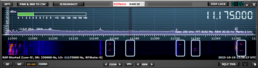

I have recently been observing an increase of "chirps" across a segment of the 11 MHz band. For me, they sound like chirps (short burst transmissions) but I guess depending on where your dial is set, these could be producing some beeps / tones.
These have been there for a while, come and go, but recently appear to be more frequent in nature than usual. I am not sure what they are. They do transmit in sync with each other (multi-channel) and I have seen them elsewhere like centred around 15 MHz.
Here is what they look like on a waterfall display.

This morning around 12:45 UTC 20 OCT 2023 those mysterious burst transmissions were very active for several hours. One was centred on 11175 which produced the aforementioned tones and beeps.
You can also see the trace from a sweeper starting at the bottom of the band and moving its way up.
