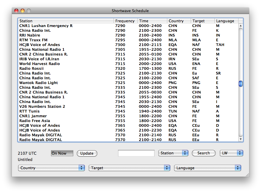

Shortwave Broadcast Schedules helps the SWL find shortwave broadcasts to listen to, as well as identify the station that is tuned in. You can double click on an entry to tune your radio to that frequency. You can also manually tune your radio, and the list of possible broadcasts will scroll along with the frequency, helping you identify the station.
It is available for Windows, Mac OS X, as well as linux.
This is the first public beta of the app. It is not yet completed, there are more features to add. It also likely has some bugs.
Presently, radio control is only implemented for Icom radios using the CI-V interface, as well as the SdrDx SDR app for Windows and Mac OS X. I do plan on adding support for additional radios, this is where users can help, by testing how it works with their radio. If you're interested in doing this, and you already have your radio connected to your computer via a serial cable, let me know what radio(s) you have.
If you'd like to try it out, you can download a copy using the following links:
Windows: http://www.radiohobbyist.org/blog/mypics/ShortwaveBroadcastSchedules-Windows.zip
Mac OS X: http://www.radiohobbyist.org/blog/mypics/ShortwaveBroadcastSchedules.zip
Linux: http://www.radiohobbyist.org/blog/mypics/ShortwaveBroadcastSchedules-Linux.zip
There is a ReadMe.rtf documentation file that comes with the download.
