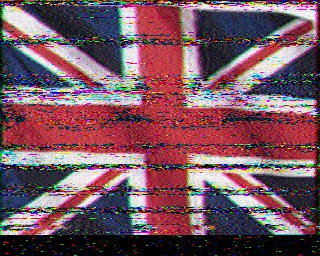

2252 SSTV.. I am not decoding this very well... ah there we go.. A union Jack
2252  God Save the Queen

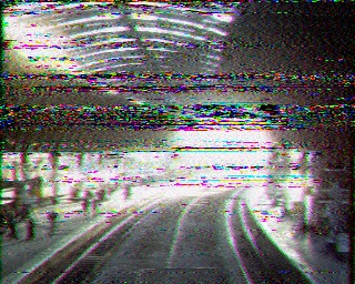

Online myteaquinn
  • Posts: 8527
Re: Radio Echo One 6925 AM 2227 UTC 14 Oct 2013
« Reply #6 on: October 14, 2013, 2259 UTC »
Kind of a crappy image thanks to the band conditions here.
By the way thanks for the program Radio Echo One.
« Last Edit: October 14, 2013, 2313 UTC by myteaquinn »

If you want to run any recordings again, the SSTV was in Scottie2

The extremely slanted image is an indicator of a severe timing problem. This can happen if the SSTV software used to generate the image is not properly calibrated, or can be induced by encoding the audio as an mp3 or other compressed format. I did decode two of the images, and had to make huge adjustments to the timing a lot to get rid of the slant.
The only way for me to save the SSTV audio is by recoding in WAV and then implanting into the show which saves as WMA.
For the record, the images are
1. Pikachu
2. York Railway Station (an awesome place to go spotting - and I took the picture myself)
3. Union Jack
« Last Edit: October 15, 2013, 1221 UTC by Echo_One »

Keeping the show as a WAV file would eliminate the timing problem, but the resulting audio files would be huge. You could keep the SSTV as a separate audio file in WAV format, and send the program audio as an mp3 or WMA or whatever, but that might be a hassle for your relay operator?
Also, for whatever reason, I have noticed that SSTV images, when transmitted in AM mode, often looked "washed out". I'm not sure if this is due to the transmitting or receiving side (or both). IIRC I've sometimes demodulated them in SSB mode, resulting in a slightly better image.

It's all my fault, I took the file and saved it as an mp3 file! :(
  • Posts: 33766
« Reply #14 on: October 15, 2013, 1754 UTC »
It would be interesting to run the original WMA file through an SSTV decoder, and see if the slant issue is there as well.
