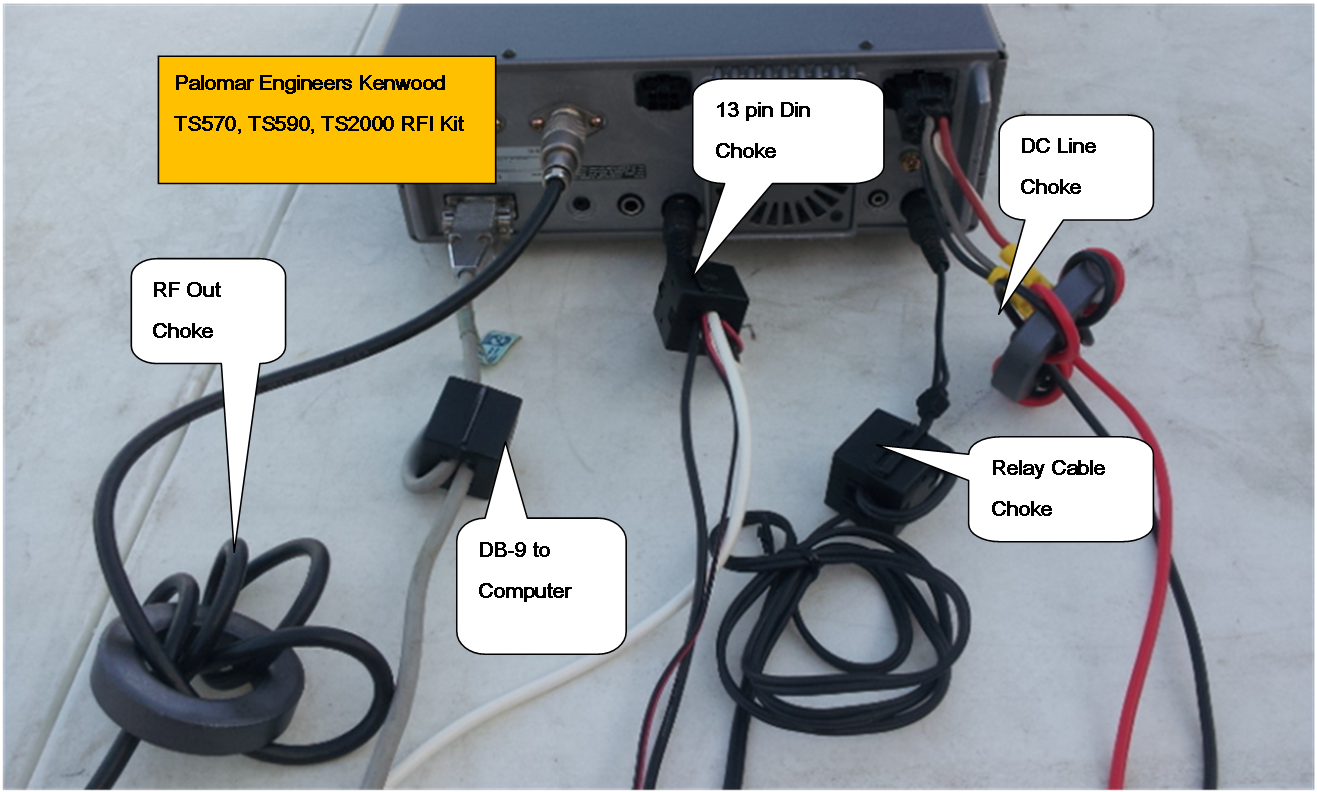

I also always recommend that all the cables entering the transmitter should be wrapped around ferrite toroids as much and with as many turns as possible. Get longer cables if you have to. The toroids should be placed as close as practical to the transmitter along the length of the cable, so, for example, a short cable run from the toroid to the transmitter and a longer run to the audio source or the DC power supply is the ideal result. Check the toroid suppliers specs and get ones that are made for suppression at HF. This may be Mix 31, Mix 43 or maybe Mix 75 but there are other possibilities.
The following image gives you some idea of where I am going. (I'm not affiliated with Palomar Engineers and I am definitely not shilling for them. This is just a convenient photo):
