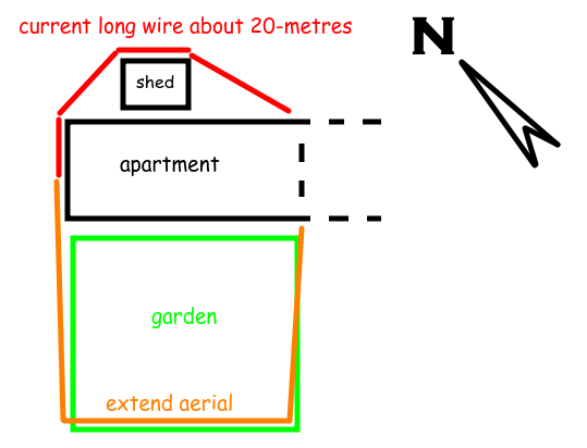

I got myself a an ATS-20+ receiver. Because I am very limited for space, I have a "long"-wire aerial: about 20-metres, with 16-metres or so running east to west (across the fron of the aparment) and about 4-metres running north to south.  The feed point is the most eastly end.
As well as general SWLing and slowly getting back into amateur radio (preferring homebrew QRP stuff), I have a "dream goal" - to get Radio Caroline, on 648 kHz. However, I am in northern Finland, near the west coast.
For this, what would be a good route - long-wire plus ATU plus pre-amp or one of those MW loop aerials with a sh!t load of turns? Or any better suggestion?

I now have two plans - 1. Build a loop and 2. extend the long wire around the side of the apartment and garden.

Looking at your diagram, it looks like you'd end up with 60 meters or so of wire antenna. That should work on MW alright. Like I said earlier, I was able to DX the MW band with a 150 ft low wire (it was 1-2 meters off the ground), which is around 50 meters, and I heard a lot of DX with it.
RE: the box or crate loop: remember that you may have to add or cut wire to get it to tune from 520-1700 kHz. I rolled my milk crate loop with 110 ft (36 meters?) and had to cut a little to get it to tune from 520-1700. Before, it was tuning into the high longwave band, and missing the higher end of the MW band (I think it stopped peaking signals around 1600 or so). I ended up cutting out a loop of wire from around the Milk crate and it tunes from 510-520 to 1700.
So, cut to fit where needed. Have fun!
