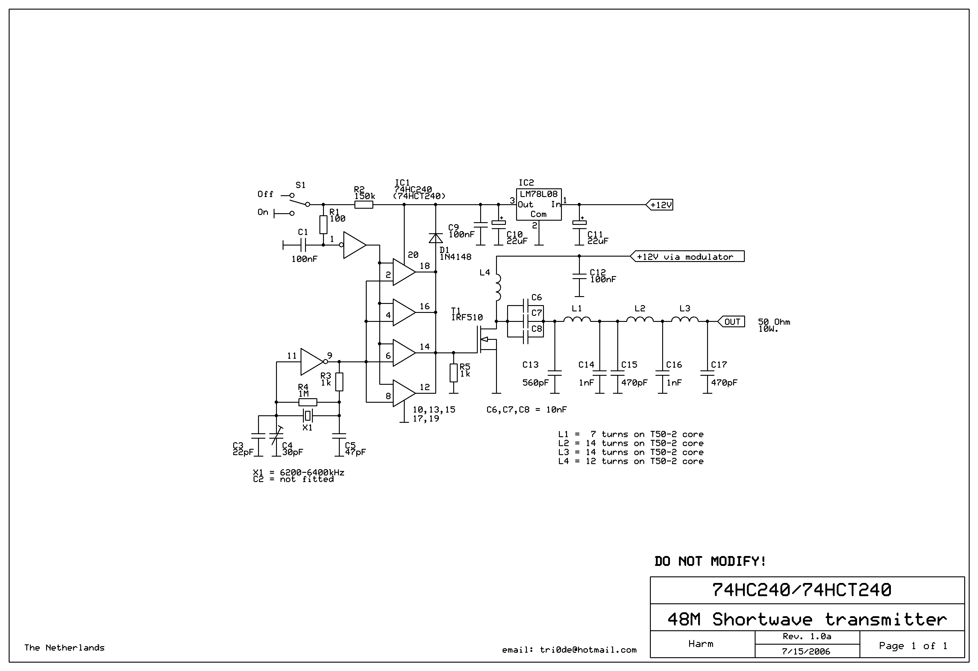

Having an L/C oscillator for the frequency you are using is rather silly especially when (if you're using 10.240) Xtals are very cheap for some frequencies and very stable too.
This design;
http://www.uploadarchief.net/files/download/74hc240-48meter(rev.A).gif
And variations of.....
http://new-ham-radio.blogspot.co.uk/2010/07/is-it-possible-to-create-qrp.html
is still the ultimate in simplicity and efficiency.
I see no reason to build anything that's more complicated and not as efficient.
Don't need 10W, don't fit the FET, you'll get a couple of 500mW out of the 74HC240.
