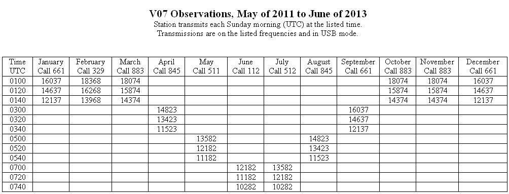

Here is the schedule V07 used from at least as early as sometime in 2010 to June of 2017.  The title of the chart says May 2011 start, but that was when I strarted with the intent of making a chart, I had casually monitored this station on what was probably this same schedule as early as 2009:
Here is the schedule as it has been for the last year or so, note that June has not been seen since the changes started, and cells in AMBER color are changes:

This station, and others in its family operated by probably the same organization, has some well defined habits.
One of those habits is that if a "null" message ( only the callup, in this case 435, sent three times, followed by 000, all repeating for just over two minutes ) is sent in the first two time slots, the third transmission will not happen.

No, it was not.  Tonight, as anticipated, this station started a new schedule, at 0700, 0720, and 0740 UTC.
While the shift in time was predicted, the frequencies used were unknowable.  It turns out the freqs were 13563 kHz, USB mode, at 0700 UTC, 12163 kHz, USB mode, at 0720 UTC, and 10263 kHz, USB mode, at 0740 UTC.

Yes, actual TX freq at 0720 UTC was 12162 kHz, not 12163 kHz.  This was almost certainly an operator error, why do I say that?  Look at the transmissions.
0700z 13563 kHz USB
0720z 12162 kHz USB
0740z 10263 kHz USB
Habitually, in every other time slot this station transmits in through the year, the ones and tens digit for a given callup are the same, in this case all the frequencies should end in 63.
Other habits to note with regards to frequency.
Concerning only the MHz digit of the frequency, the frequencies go down by 1 or 2 MHz increments for each successive time slot.  XX20 is 1 or 2 MHz lower than the XX00 time slot, and XX40 is 1 or 2 MHz lower than the XX20 time slot.  This habit is true for the far eastern outlet of this station, the western outlet (when one is active) inverts this, so each successive transmission is 1 or 2 MHz higher than the last.
Concerning only the 100 kHz digit of the frequency, the callup matches the 100 kHz digit for each time slot.  The callup, the 3 digit number repeated over and over at the beginning of the transmission, for the transmissions this month is 512.  Note the 100 kHz digit in each frequency, 13563 kHz, 12163 kHz, and 10263 kHz, 5, and 1, and 2.
This makes it easier to find unknown frequencies.  If you find any one frequency in a callup set you can narrow down the other two freqs to a couple of options each.  By finding 13563 kHz at 0700z with a callup of 512 that told me the 0720z transmission was probably going to be on 12163 or 11163 kHz, and the 0740 TX was probably going to be on 11263, or 10263, or 9263 kHz.  And if you look at the July and August transmissions for last year you will see this station used the 13563 / 12163 / 10263 kHz set those months.  SO that was a safe bet for this month.
For whatever reason this station has reduced itself to 4 sets of frequencies, and so 4 callups, it has used in the last year.  In previous years it had more sets in use.
