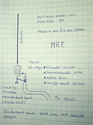

Simple vertical antenna (modified 11 mtr/27mc antenna)
drawing by MRF/Netherlands
André
