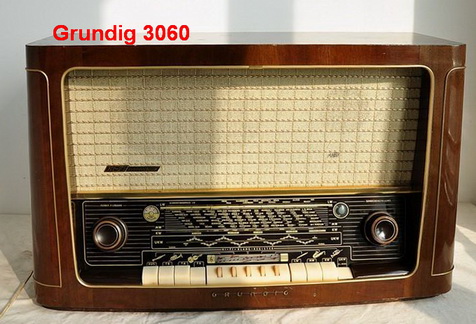

Is it maybe an idea - to buy - a cheap - old "vintage" tube radio
and do some adjustments to make it a good receiver on MW ?
(Service Manuals are for 99% of most known brands available Online!)
These oldies mostly have great RX on MW !
André
