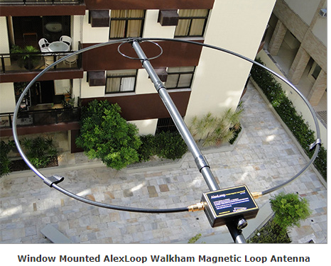

Able to mount a loop like this out the window?
Agree with the others, anything outside is going to be much better.  Especially regarding the RF noise you are going to pick up from every electronic thing in the building.  I lived not too far from you in East Anglia for a time, and ran an MFJ1622 inside for a few months.  It worked.  RX and TX were obviously much better once I got wire outside in the garden.

Thanks for your suggestions guys. I think putting something out of the window like that would probably work. Whats the situation with the size of the loop - is that tied to frequencies in a similar way to dipole setups, or is it just a case of as "big as you can fit"?
