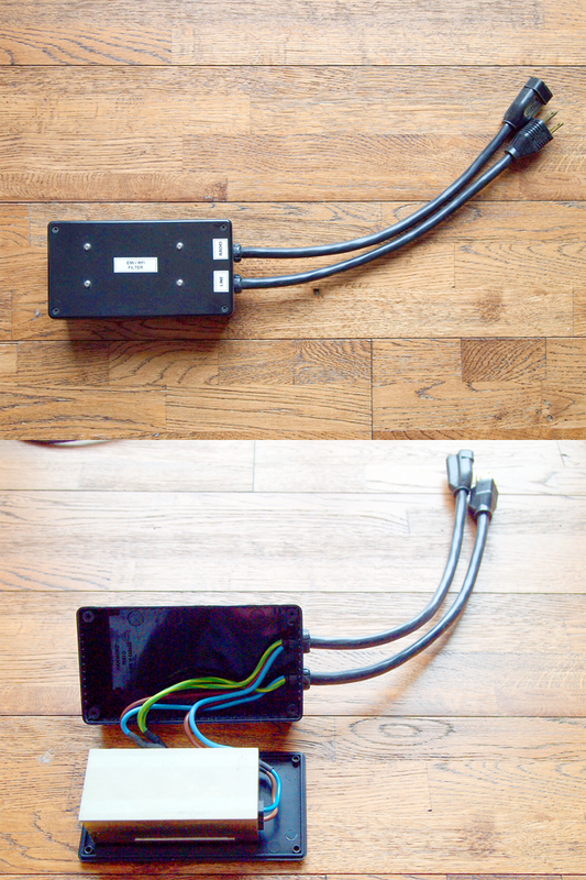

This is my Schaffner EMI/RFI filter arrangement.
I also incorporated a fuse on the line side in the later design thinking that if something was to go wrong with the filter then it could present a dead short all the way to the fuse/breaker panel. I also recently seen a video where someone put 77 and 43 ferrites (5 ~ 8 turns ea) on the input and output leads and that had a significant improvement on reducing noise. You are obviously look at larger core ferrites and a much larger enclosure. None the less, if you get a 15 amp or more Schaffner then it might be worth the effort and filter out an entire 15 amp branch circuit.
« Last Edit: March 05, 2024, 0116 UTC by ~SIGINT~ »
