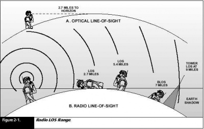

UHF and VHF range handheld radios range line of sight improving handheld tactical voice radio range discussion
VHF UHF Line Of Sight VULOS Tactical Radio line-of-sight LOS example diagram
Inter Squad Radio (ISR) - Handheld Tactical Militia Radio - not to be confused with intra-squad radio (see below).
UHF frequencies (including all the 462 MHz/467 MHz FRS/GMRS channels and 464 MHz/467 MHz Dot/Star frequencies) generally perform better on handheld radios due to antenna considerations. VHF frequencies (including the MURS channels) perform better with mobile (vehicle mounted) antennas. In urban areas, UHF provides considerably better penetration of buildings and requires a much smaller antenna. This makes UHF ideal for inter squad and intra squad tactical communications. VHF (MURS) may be used in urban areas as well, but performs better in rural or suburban areas. Both VHF and UHF are line of sight LOS). This means that the tops of high-rise buildings, overlooks, rises in terrain, hill tops, mountaintops and other locations that overlook the surrounding area will provide surprising increases in range from tactical VHF/UHF handheld radios such as the Baofeng UV-5R, UV-82, BF-F8+, UV-82HP, Pofung versions, Quansheng TG-UV2, Wouxun KG-UVD1P, KG-UV6D, KG-UV9P, KG-805G, etc.
Line of sight (LOS) at VHF/UHF frequencies (FRS and MURS frequencies). Note that these range estimates are with no obstructions.
In an urban area (with numerous obstructions), two handheld radios at street level can expect closer to 1-2 mile range. However, increasing the height of just one of the two radios will significantly improve communications reliability. If both radios are located above the average ground level, communications range increases drastically. The prudent thing to do is acquire topographical maps of the intended and possible area or areas of operations...noting which locations are rises or hills above the surrounding area. In an urban setting, this is extremely important. On VHF (MURS), modern steel, concrete, cement, etc. construction will block communications quite effectively. Get up as high as you can to improve communications link reliability.

Line of Sight LOS Range Estimations for VHF/UHF Radios VULOS
  • Radio A - 5 feet above ground communicating with Radio B - 5 feet above ground = 5 miles line of sight range
  • Radio A - 20 feet above ground communicating with Radio B - 5 feet above ground = 9 miles line of sight range
  • Radio A - 30 feet above ground communicating with Radio B - 5 feet above ground = 11 miles line of sight range
  • Radio A - 50 feet above ground communicating with Radio B - 5 feet above ground = 13 miles line of sight range
  • Radio A - 100 feet above ground communicating with Radio B - 5 feet above ground = 17 miles line of sight range
  • Radio A - 20 feet above ground communicating with Radio B - 10 feet above ground = 10 miles line of sight range
  • Radio A - 20 feet above ground communicating with Radio B - 20 feet above ground = 12 miles line of sight range
  • Radio A - 30 feet above ground communicating with Radio B - 10 feet above ground = 12 miles line of sight range
  • Radio A - 30 feet above ground communicating with Radio B - 20 feet above ground = 14 miles line of sight range
  • Radio A - 30 feet above ground communicating with Radio B - 30 feet above ground = 16 miles line of sight range
  • Radio A - 50 feet above ground communicating with Radio B - 10 feet above ground = 14 miles line of sight range
  • Radio A - 50 feet above ground communicating with Radio B - 20 feet above ground = 16 miles line of sight range
  • Radio A - 50 feet above ground communicating with Radio B - 30 feet above ground = 18 miles line of sight range
  • Radio A - 50 feet above ground communicating with Radio B - 40 feet above ground = 19 miles line of sight range
  • Radio A - 50 feet above ground communicating with Radio B - 50 feet above ground = 20 miles line of sight range
  • Radio A - 100 feet above ground communicating with Radio B - 10 feet above ground = 18 miles line of sight range
  • Radio A - 100 feet above ground communicating with Radio B - 20 feet above ground = 20 miles line of sight range
  • Radio A - 100 feet above ground communicating with Radio B - 30 feet above ground = 22 miles line of sight range
  • Radio A - 100 feet above ground communicating with Radio B - 40 feet above ground = 23 miles line of sight range
  • Radio A - 100 feet above ground communicating with Radio B - 50 feet above ground = 24 miles line of sight range
  • Radio A - 100 feet above ground communicating with Radio B - 60 feet above ground = 25 miles line of sight range
  • Radio A - 100 feet above ground communicating with Radio B - 75 feet above ground = 26 miles line of sight range
  • Radio A - 100 feet above ground communicating with Radio B - 100 feet above ground = 28 miles line of sight range
  • Radio A - 200 feet above ground communicating with Radio B - 5 feet above ground = 23 miles line of sight range
  • Radio A - 200 feet above ground communicating with Radio B - 10 feet above ground = 24 miles line of sight range
  • Radio A - 200 feet above ground communicating with Radio B - 25 feet above ground = 27 miles line of sight range
  • Radio A - 200 feet above ground communicating with Radio B - 50 feet above ground = 30 miles line of sight range
  • Radio A - 200 feet above ground communicating with Radio B - 75 feet above ground = 32 miles line of sight range
  • Radio A - 200 feet above ground communicating with Radio B - 100 feet above ground = 34 miles line of sight range
  • Radio A - 200 feet above ground communicating with Radio B - 125 feet above ground = 36 miles line of sight range
  • Radio A - 200 feet above ground communicating with Radio B - 150 feet above ground = 37 miles line of sight range
  • Radio A - 200 feet above ground communicating with Radio B - 175 feet above ground = 39 miles line of sight range
  • Radio A - 200 feet above ground communicating with Radio B - 200 feet above ground = 40 miles line of sight range
  • Radio A - 500 feet above ground communicating with Radio B - 5 feet above ground = 35 miles line of sight range
  • Radio A - 500 feet above ground communicating with Radio B - 10 feet above ground = 36 miles line of sight range
  • Radio A - 500 feet above ground communicating with Radio B - 25 feet above ground = 39 miles line of sight range
  • Radio A - 500 feet above ground communicating with Radio B - 50 feet above ground = 42 miles line of sight range
  • Radio A - 500 feet above ground communicating with Radio B - 75 feet above ground = 44 miles line of sight range
  • Radio A - 500 feet above ground communicating with Radio B - 100 feet above ground = 46 miles line of sight range
  • Radio A - 500 feet above ground communicating with Radio B - 150 feet above ground = 49 miles line of sight range
  • Radio A - 500 feet above ground communicating with Radio B - 200 feet above ground = 52 miles line of sight range
  • Radio A - 500 feet above ground communicating with Radio B - 250 feet above ground = 54 miles line of sight range
  • Radio A - 500 feet above ground communicating with Radio B - 500 feet above ground = 64 miles line of sight range
  • Radio A - 1000 feet above ground communicating with Radio B - 5 feet above ground = 48 miles line of sight range
  • Radio A - 1000 feet above ground communicating with Radio B - 10 feet above ground = 49 miles line of sight range
  • Radio A - 1000 feet above ground communicating with Radio B - 25 feet above ground = 52 miles line of sight range
  • Radio A - 1000 feet above ground communicating with Radio B - 50 feet above ground = 55 miles line of sight range
  • Radio A - 1000 feet above ground communicating with Radio B - 100 feet above ground = 59 miles line of sight range
  • Radio A - 1000 feet above ground communicating with Radio B - 150 feet above ground = 62 miles line of sight range
  • Radio A - 1000 feet above ground communicating with Radio B - 200 feet above ground = 65 miles line of sight range
  • Radio A - 1000 feet above ground communicating with Radio B - 250 feet above ground = 67 miles line of sight range
  • Radio A - 1000 feet above ground communicating with Radio B - 500 feet above ground = 77 miles line of sight range
  • Radio A - 1000 feet above ground communicating with Radio B - 750 feet above ground = 84 miles line of sight range
  • Radio A - 1000 feet above ground communicating with Radio B - 1000 feet above ground = 90 miles line of sight range
See also: Common VHF Itinerant Frequencies, AM and SSB CB frequencies, Hunt Club Frequencies and the American Redoubt Radio Operators Network (AmRRON) and The American Preparedness Radio Network (TAPRN) pages. Specific AM and SSB 11 meter CB frequencies are included - 26.985 MHz AM, 27.005 MHz AM, 27.365 MHz USB, 27.368 MHz USB, 27.375 MHz USB, 27.378 MHz USB and 27.425 MHz...see also, military tactical militia frequencies patriot radio networks militia tactical frequency plan.
The 22 UHF FRS channels and 5 VHF MURS channels form the backbone of the VHF/UHF tactical and command networks used by militia groups. The 22 FRS channels are used in addition to the 5 MURS channels. Because FRS is on the UHF band, it performs better for inter squad and intra squad radio compared to VHF. FRS considerably outperforms MURS in urban environments. MURS, however, offers greater range on a watt-for-watt basis. CB and 11 meter frequencies will give the best range (especially in rural areas). Base stations with CB and VHF (MURS) capability are recommended for command and control. Handheld militia radios should be programmed with the 5 MURS channels and the 22 FRS channels at a minimum.
Lower frequencies, including VHF low (30-50 MHz) and the 11 meter freeband and CB channels (25-28 MHz) will provide better range, provided good antennas are used. Lower frequencies will bend beyond the horizon slightly (better than VHF and much better than UHF). The 11m band (including the CB frequencies) provides excellent vehicle to vehicle communications properties if decent antennas are used. With SSB equipment on a clear frequency, long range tactical and command nets are possible with the 25-28 MHz region.
